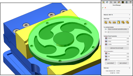

Using Cylindrical Stock for Milled Parts
Another time-saving feature added to SOLIDWORKS CAM & CAMWorks 2021 is the ability to more quickly define and use cylindrical stock for milling. In previous versions cylindrical stock for turned parts was defined automatically but for milled parts, a SOLIDWORKS sketch was required. However, in the new 2021 version an icon has been added to the Stock Manager to use cylindrical stock for milling. Once selected, pull-downs can be used to select the origin and orientation of the cylinder. Parameter values can be entered to easily define the diameter and length of the cylindrical piece of stock. A “Minimum Diameter and Length” button is also provided which instantly calculates a bounding cylinder around the part and offset controls are also available to add stock to the outside, bottom, and/or top of the part to assist in quickly determining the ideal stock size.
Cylindrical
