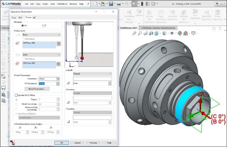

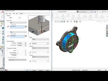

| How to setup a Probing Operation on Mill-Turn
In CAMWorks 2021 it’s easy to create a new probing operation and associate it to an existing setup. Choose the desired probe from your tool-crib, and select the previously machined surfaces to create new coordinate references for the subsequent machining operations. It’s easy to move the probing operation to any location in the program. CAMWorks 2021 makes it fast and easy to create your most complex manufacturing operations and easily add probing operations to verify them.
