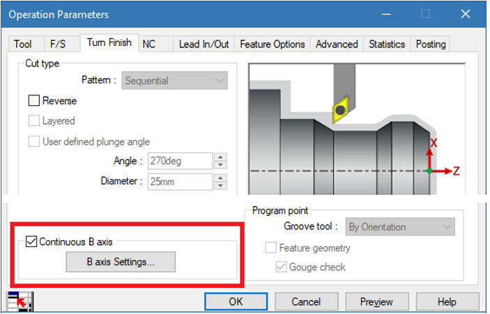

Continuous B Axis Functionality for Turn Finish Operations

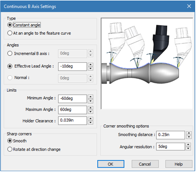

Enabling the additional checkbox in the Turn Finish operation gives access to the settings used to control this new functionality. These parameters allow control of the B axis as either;
Constant angle – the tool remains at a specified Effective Lead Angle, and will tilt only while cutting any undercut areas. This will result in lesser number of tool rotations.
At an Angle to the Feature Curve –  the tool will always maintain the same Effective Lead Angle or Normal Angle while machining each segment of the feature. This will result in higher number of tool rotations.
Other parameters allow for the setting of angular limits for the B axis rotation, holder clearances and how to transition around sharp corners.
