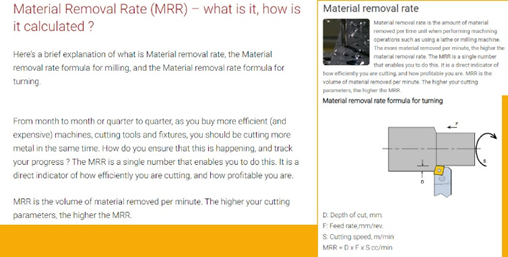

With the ongoing race to efficiency and Aero/Space Machining of exotic materials like 718 Inco.  Ceramics has played a unique role in getting to MRR effectiveness.
In the 80s, insert geometry was limited to material grades and style, making use for forms of roughing in Cast Iron only. Still the same bottom line rang true then as it does today, MACHINE TIME IS MONEY.
The fastest way to remove the most amount of material opens up machine time,…. and thus profits.

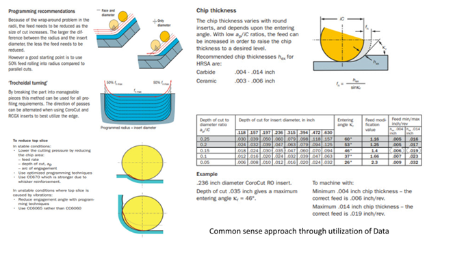

The introduction of CAM Programming has also created newer revolutionized Tool Path that creates a systematic and Time tested approach, where the calculating of the time in cut and advanced methods of lead-in and out and Chip Thinning,  maximizes the use and life of the Ceramic insert, creating more accurate quote times and lead time predictions and ultimately a super accurate Stream Line process.

Since evolving with new machine tools and abilities to more precision machining applications the Ceramic tool is no longer limited to Turning with a blunt type insert.
These new tool processes and material types and structures have led way to producing new and accurate molds for endmill and end-milling applications as well as Grooving and Face-milling.
