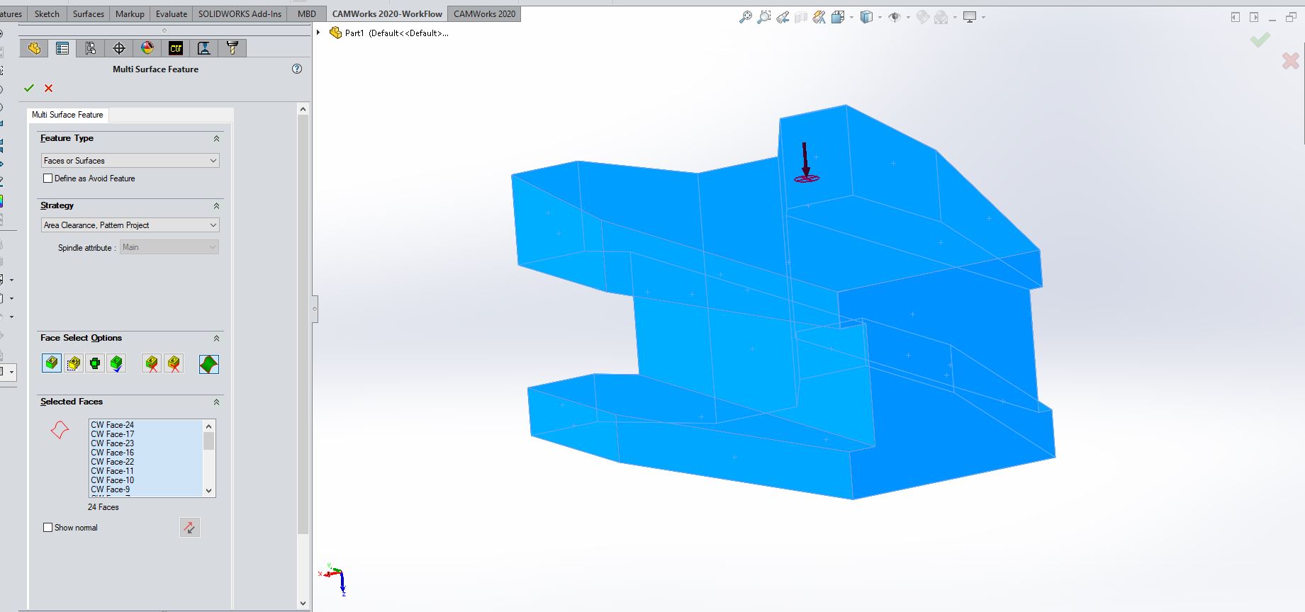

But now that thinking has been automated. The shop programs base and plate machining using CAMWorks software from TekSoft (Scottsdale, Arizona). CAMWorks uses feature recognition algorithms to identify machined features of a part model automatically, and it uses a database of user-specified tools, toolpath preferences and assignment rules in order to generate a machining routine for each of the features it finds. While Mr. Wendtlandt still has to oversee the programming with this software, the time he saves is considerable. A mold that used to take 2 weeks for him to program now takes 2 days.

The software makes the correction interactive and easy. For a given model, the software presents a list of the features it identified, and Mr. Wendtlandt clicks through the list quickly to make different identifications. Once the features have been correctly named in this way, the correct tools and tool paths are assigned to the features automatically, and the complete NC program is built up from these choices.
