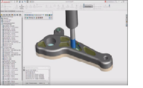

SOLIDWORKS CAM is a great way for SOLIDWORKS users to utilize CAM programming technologies for their manufacturing needs. SOLIDWORKS CAM is available to SOLIDWORKS customers at no additional cost, with SOLIDWORKS Version 2018 and later, on subscription. SOLIDWORKS selected CAMWorks to power its SOLIDWORKS CAM software.
How Do You Access SOLIDWORKS CAM?
If you are using SOLIDWORKS Version 2018 or later and are currently on subscription, you already have SOLIDWORKS CAM. To activate it, go to the Add-Ins menu in your SOLIDWORKS software and select SOLIDWORKS CAM in the SOLIDWORKS Add-Ins options.
Once you have activated your SOLIDWORKS CAM, there are several Tutorials to help walk you through using it. You can find these under the SOLIDWORKS CAM Help Menu and Tutorials.

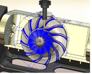

CAMWorks Standard includes everything included with SOLIDWORKS CAM Professional, plus Sub-Spindle and Rotary Milling.
CAMWorks Milling Standard then adds 3 Axis Milling Level 2 and CAMWorks Turning Standard adds Mill Turn. CAMWorks Milling Professional adds 3 Axis Milling Level 3 and CAMWorks Turning Professional adds Synchronous Machining for lathes and Virtual Machine Standard.
CAMWorks Premium is the highest level of functionality and includes functionality from all the products, including 5 Axis Simultaneous Milling. Add-on products available include VoluMill for 3 Axis, Virtual Machine Professional and Premium, PrimeTurning™ from Sandvik Coromant, Wire EDM, NestingWorks and CAMWorks ShopFloor.
