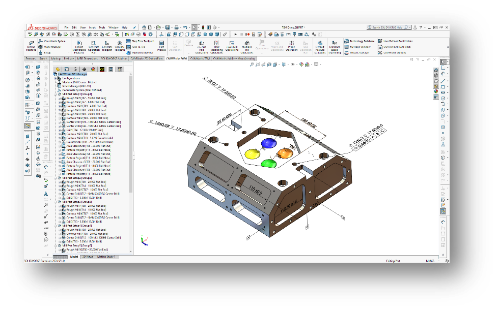

Tolerance-Based Machining (TBM) in HCL CAMWorks software reads and identifies tolerance data in 3D models, providing manufacturing companies the ability to automate toolpath generation and move toward paperless machining.

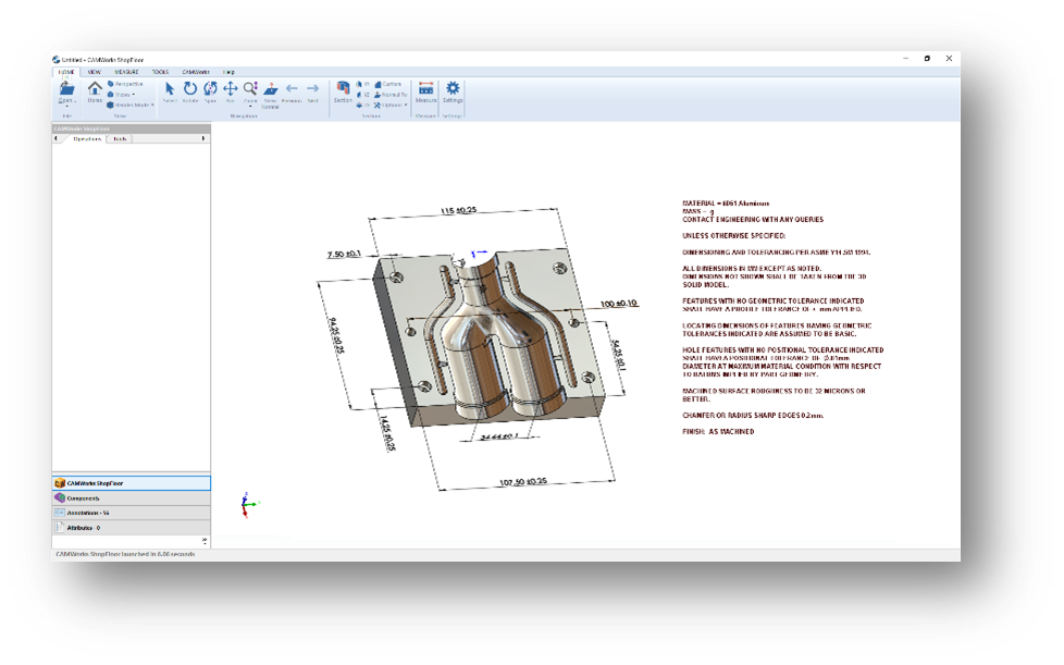

Moving to paperless machining can be difficult because CAD/CAM models rarely include all the information that machinists need. However, with the advent of Product Manufacturing Information (PMI) – such as dimensions, tolerances, and GD&T information – and Model Based Design (MBD), all the necessary manufacturing information can now be added directly to the 3D solid model. Tolerance Based Machining recognizes and uses this data, eliminating the cost of manual tasks involved when using 2D drawings.
The next major innovation in CAM software will be ability to leverage the MBD information in 3D digital models to automatically generate CNC programs that will meet the specified quality requirements.
TBM Handles Models Without Dimensions
DimXpert + Tolerance Based Machining
With the introduction of Tolerance Based Machining by CAMWorks, the manual tasks associated to preparing parts with close tolerances, asymmetric tolerances, surface finishes and other drawing annotations for toolpath generation will now be part of the past. Not only does CAMWorks automatically identify manufacturing features and automatically create toolpaths, CAMWorks will now recognize the tolerances and surface finishes associated with a feature to select the appropriate tools, speeds, feeds, etc… to generate the best toolpath. For the first time, an application that leverages this information to automate and dramatically accelerate the manufacturing process is now available.
