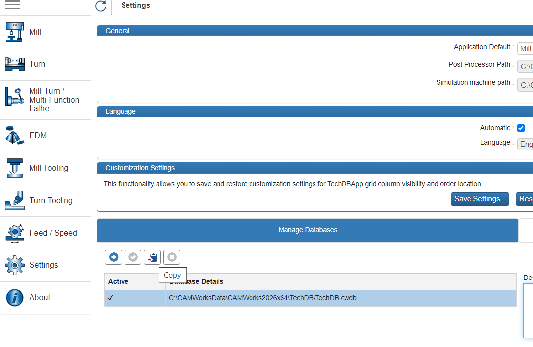

Important: CAMWorks ships with a default TechDB (TechDB.cwdb). Before changing anything, make a backup copy of this file. Go to the “Settings” tab and at the bottom right you’ll see a command to make a copy of this file. TechDB can handle multiple databases, and any database can be made active.

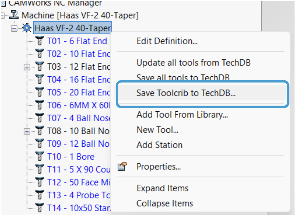

The easier approach is to assign an empty toolcrib to your machine and fill up the stations in CAMWorks. The toolcrib can be saved using the command “Save Toolcrib to TechDB.”
Screenshot of the Tool Crib setup in CAMWorks showing tool stations
Assigning and filling toolcrib stations in CAMWorks.
Practical advice: Don’t try to enter every tool on day one. Start with the bare minimum tools that appear in 80% of your jobs. Add more as jobs require them. An incomplete but accurate tool crib is far more useful than a complete but inaccurate one. Use “Save Toolcrib to TechDB” whenever you add a new tool.

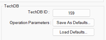

Important: CAMWorks allows saving of the Default Operation Parameters. Rather than changing the parameters directly in the TechDB app, define operations in CAMWorks and change the parameters to get the toolpath that you expect. Save the defaults from the Operations Parameters screen.

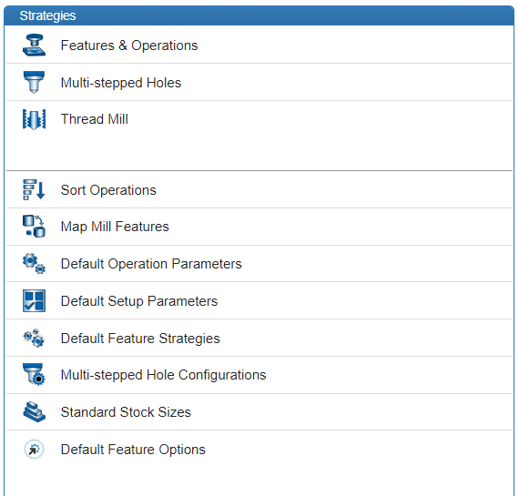

Step 5: Write Machining Strategies (Rules)
This is the most powerful part of the TechDB. Strategies define the sequence of operations for a feature — not just how to cut, but what to do first, second, and third.
Navigate to Strategies to see rules organized by feature type:
  • Hole features — spot drill → drill → tap (for threaded holes), or spot → drill → ream (for precision bores)
  • Rectangular pockets — rough pocket → contour finish → floor finish
  • Circular pockets — similar, with tool selection based on pocket diameter
  • Bosses — rough → finish contour

For each feature type, you can specify:
  • Which operations to apply and in what order
  • Minimum/maximum feature dimensions that trigger the rule (e.g., use a different strategy for small holes vs. large holes)
  • Material-specific overrides

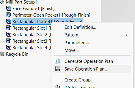

A practical starting point: Don’t write custom strategies directly in the TechDB. Instead, let CAMWorks generate toolpaths using its default strategies, review the results, identify the most common correction you make (e.g., “I always add a spot drill before drilling”), and write a rule to automate that single correction. Iterate from there.
Over time, your strategies will capture more and more of your tribal knowledge, and the amount of manual editing after feature recognition will shrink accordingly.

  • Save tools and tool cribs — these tools will get loaded by default when you program your next part.
  • Save Strategies (“Save Operation Plan”) for Feature Based Machining, or Save Default Operation Parameters (“Save as Defaults”) for process-based NC programming.
